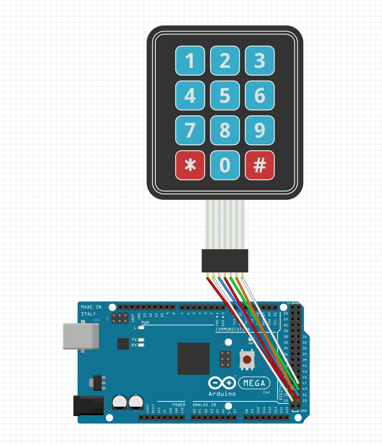

3x4 Keypad Example

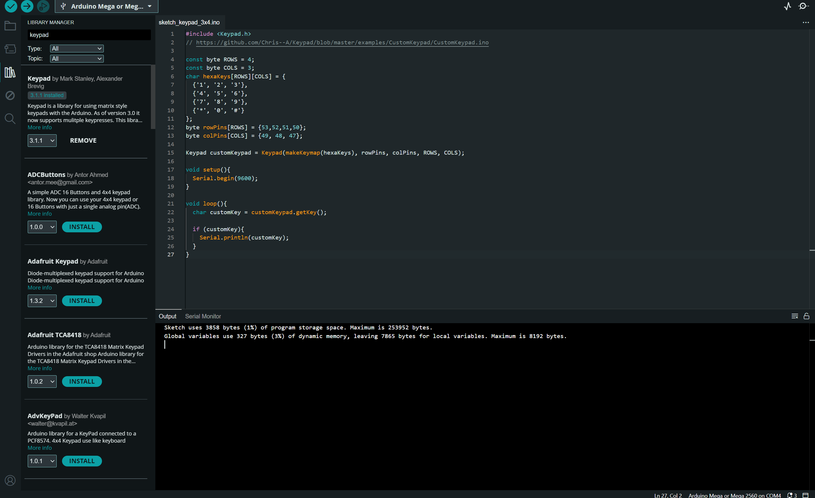

Libraries used
GitHub - Chris–A/Keypad: A version of the keypad library found in Wiring. This is just a copy made compatible with the Arduino IDE library manager.
Or you can install from library manager
Code
Based off Keypad/examples/CustomKeypad/CustomKeypad.ino at master · Chris–A/Keypad · GitHub
#include <Keypad.h>
const byte ROWS = 4;
const byte COLS = 3;
char hexaKeys[ROWS][COLS] = {
  {'1', '2', '3'},
  {'4', '5', '6'},
  {'7', '8', '9'},
  {'*', '0', '#'}
byte rowPins[ROWS] = {53,52,51,50};
byte colPins[COLS] = {49, 48, 47};
Keypad customKeypad = Keypad(makeKeymap(hexaKeys), rowPins, colPins, ROWS, COLS);

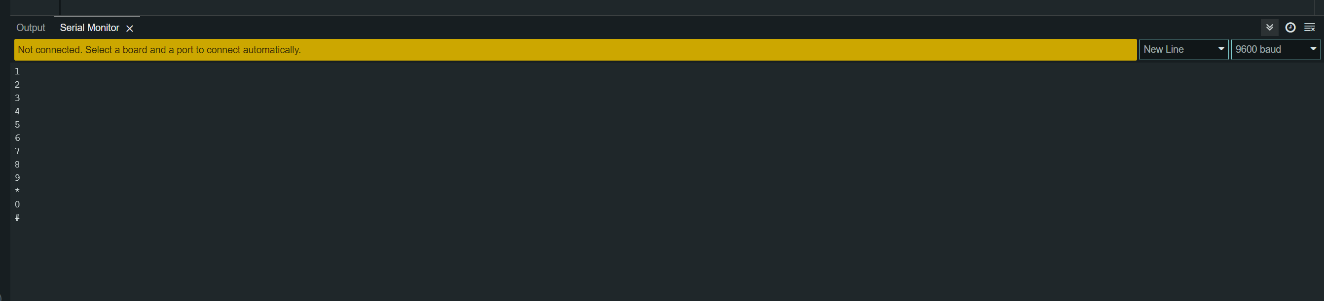

void setup(){
  Serial.begin(9600);
void loop(){
  char customKey = customKeypad.getKey();
  if (customKey){
    Serial.println(customKey);

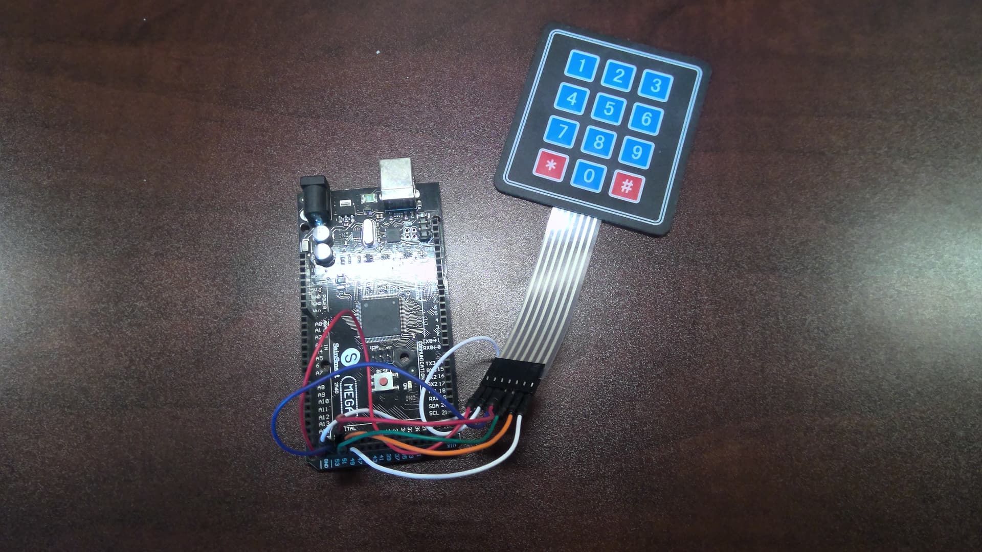

Demo of working
