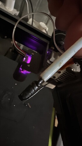

This is what it looks like after pulling apart the hotend and removing the nozzle. I was then able to push it through (I couldn’t pull it back out the way it came in).
